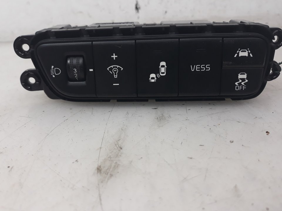

Has anyone been able to get a part number for the VESS factory switch used in Europe? I think it may be on the older 2020 /2021 models since the Europe guys have said it is not on the 2022 EV.

Here are some possibilities: 2018 Niro EV 93700Q4000WK 93700Q4000WK INTERRUPTOR PARA KIA NIRO / / | eBay
Double switch 93700Q4010WK
May not fit but promising KIA 93700-G5260WK / 93700G5260WK NIRO 2016 Controller/switches
I will see what I can find. Unfortunately it uses the 5-switch part not the 4-switch part.

Hey all, so European switch panels seem to have the same pinout and function regardless of button location. They are 100% plug and play with the US cars. All functions work correctly regardless of button position. The only thing that doesn't work is the headlight height adjuster wheel since that isn't supported in the US. The scroll wheel just doesn't do anything.
Please note, some Niros have 4 button slots and some have 5. Make sure you get one that fits in the same dash hole (same number of button slots.)

Does that mean if you swap the switch panel the VESS control works without any further configuration?
View attachment 7519 View attachment 7520
You don’t happen to have a part number for this golden little item?
