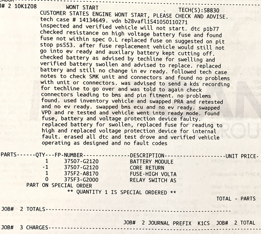

4/14/21 my 2017 Touring at 61000 miles shut off while driving - gave hybrid system error. Gasoline engine kicked in so I drove it back home (I was less than a mile away) - shut it off and would not restart. Towed to dealer same day - we are now on. Day 4 and they literally can’t figure it out. It’s setting in the parking lot with the hood popped and back seat out while they consult with “KIA” what ever that means. I’m calling tomorrow suggesting they check this High Voltage Fuse that others have mentioned. Will update.

Glad to hear it was resolved. Interesting that they thought the fuse tested good, but when they replaced it, apparently it solved the problem.
Registered
3 Posts
That’s what the technician said as well. He said he checked it multiple times and that it tested “good” every time.

Looks like I will add to the unfortunate ones having the dreaded “Hybrid System Error”. I have a 2017 HEV Niro with less than 30K miles and my son was driving and got the error message. He was able to make it home, but once the car was turned off it never came back on. Tried jumpstarting and 12V battery reset with no luck. Finally had it towed to a dealer where is has been for almost 4 weeks. They have tried replacing 12V battery and fuses but still not able to get the car to turn on. It has taken longer due to backordered parts, but its frustrating. The dealer is waiting on the KIA “field tech” to diagnose the problem further. Will update the thread if/when it gets resolved.
Finally got my car back after 5 weeks at the dealer. Here is the list of items the techs did to get it back running again:
Appears that in addition to the 12v battery and fuses the wires and voltage protection device all needed to be replaced. I still have one issue that I need to get my dealer to fix; my spare smartkey fob no longer works and needs to be recoded.
