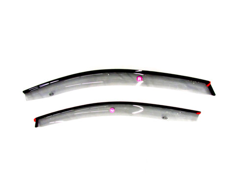

... but they do. They're in the accessories catalog, and are linked above. We got them for my husband's Rio from our dealer, and they're not very good looking. Sadly, they're about the only ones to be found for the Rio. You can see them in this picture. I have an aftermarket set ordered for my Niro, and they should be here by the end of the week.
As for removal, pop out the plastic pins (they aren't screws), pry down the top of the window channel inside the door window frame, and remove the metal clips. Grab a hair dryer, and start heating along where the adhesive tape is (it's not glue), and gently start pulling them from one end to the other.
